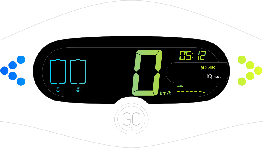

  3. Hold down the brake lever and lightly press the “GO” button; you’ll see the speedometer on the dashboard start counting down. The scooter enters motor standby mode as “0” appears on the speedometer.

Motor is activated in standby mode

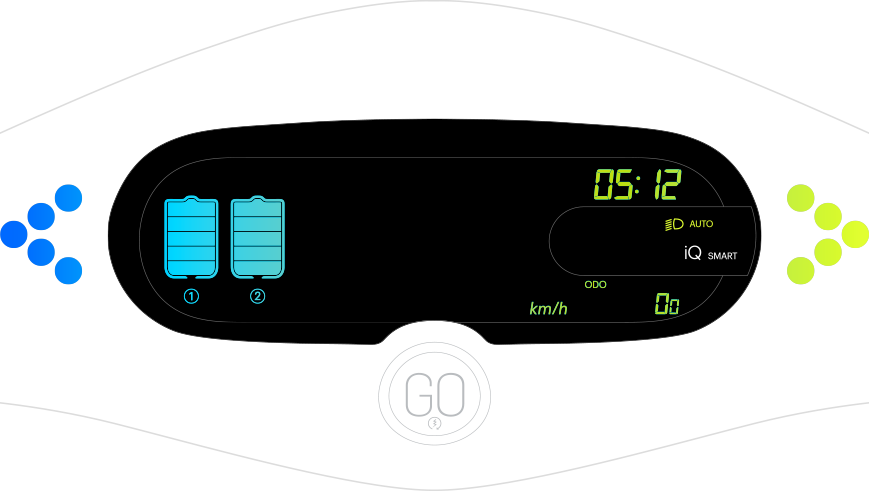

Motor off display

  • Hold the brake lever and lightly press the “GO” button or extend the side stand to shut the motor off; the speedometer display turns off and the electronic throttle stops to respond.
